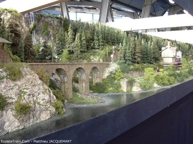

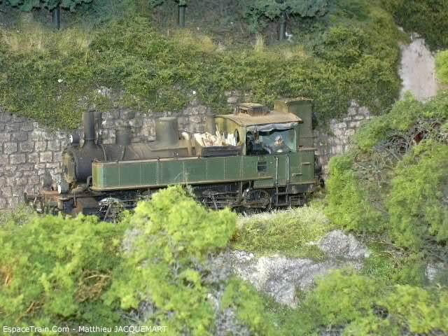

I found following foto's taken by Mathieu Jacqumart
during the show in Sedan 2003. It shows very clearly
the relation bridge - limefactory and a weathered loco
regards Jacq
